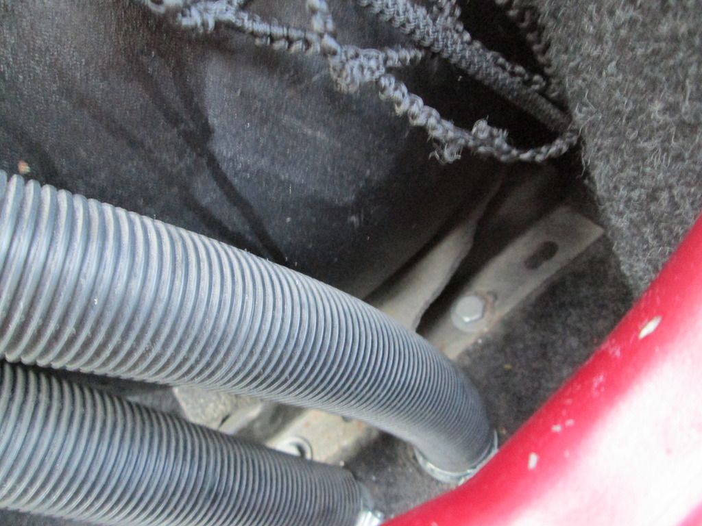

Hello friends, I hope the photos have been clear and clear.
17inc wheels front augers pressed rear also do not know what kind of event :)
The red retrofit button on the right is the horn. The airbag wrap is broken from her this way. Airbag fault light is off.
Catalyst has been canceled, performance air filter installed.
Is the tube mounted in this way, the number of belts is sufficient, at the bottom there is insulation material.
Insulation looks a little ...
In this way, the vehicle brakes or rods are solid.
I did not take a picture but I would be glad if anyone said that I was left.
Sorry for my typo on my phone.

First of all, they want to have a coffee table under the tank and now press the tube tanks with insulation .. I guess they won't say something to the filter like that.
08.05.2020 20:12 # 3
ggitaristt
The horn catalyst tube remains clear of them. The springs used to be a slight defect but now I'm not sure.
08.05.2020 20:12 # 4
Narkotik
You are out of the catalyst, teacher, don't go to waste
08.05.2020 20:12 # 5
talip206
You also have to stay because of the tube because if the tank is on the side, you need 3rd Generation. You have the coffee table and insulation but no 3rd Generation.

90% remains from the horn.
plus they can leave the ones with big rims on vehicles with a spring replacement or dropped,
My advice is to wear a 14 "15" rim on the way to the inspection.

[QUOTE = Storm61] My brother is going to be examined in the industry now, you will see whatever problem you have, you will have one month repetition for the seriously defective ones [/ QUOTE]
If it remains due to LPG, it should go to the mechanical engineers room and get a non-attack report. Both time and money loss

It does not pass with the cancellation of the floor. My friend shared how the tube will be processed. It passes through the bow but I don't think it will go through the rear torsion, it is very flat. The process of torsion adjustment on the back needs to be removed a little.

Thanks to everyone to see you after the examination prdxy 2017-02-19 10:35:52
08.05.2020 20:12 # 13
prdxy
I've passed friends :) You're new to Buddha. prdxy 2017-04-13 11:24:09
