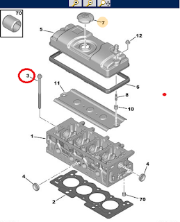

When I opened my car engine oil filler cap 11 is not part of the No. https://4.bp.blogspot.com/-mug5eg6soa8/xghwqargvbı/aaaaaaaaıim/fuow8uk3pdmtwkımp6edlrbf4lupr52ewclcbgas/s320/pr_01_1800.png looked inside and saw the mast engine oil cover when the vehicle is taking. My previous 206 had part 11 under the oil cap, and when I opened this cap while the vehicle was running, there would be no oil splashes.
The absence of this piece is a problem and a lack. I don't have the 2001 model 1.6 8v car, but I had the 2006 model 1.4 gasoline car.
foto1
There is no direct valve when you open the oil filler cap.
foto2
My hair does not have this hair cap. Does anyone know the name of this material? Could this be the reason why oil comes from the oil cap and the oil breather hose?

There is also in my vehicle. I think it should be. Otherwise, the cap explicitly drains the oil or begins to leak from the seal.
You mentioned the other thing about the oil steam hose. Normally that pipe will be oiled, but since it does not have an inner cap, it will throw more than that pipe.
Excessive oil from the oil vapor hose may cause the throat butterfly to become dirty more quickly.
It also quickly changes the idling settings.
