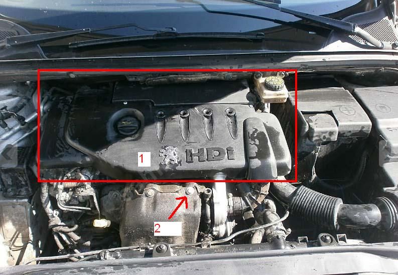

what are the names of the parts in the picture

In 2004 model 307's there is no part 1. I do not have this cover in my vehicle, and some of the other 307's that I have looked at do not exist. what should be the name of the part, exactly what the screw No. 2 has fallen on me. What can I look for and find it? I wonder what's the name?
Thanks for your help already.

Part 1 is the plastic engine top cover you call. The air filter is under the blah (it is removed when it is replaced). It is there to protect the upper side. I did not see what is not, but since it is attached with nails, after a while, the nails can break and it may have been removed instead of fixing it with screws or something. The originals were 70-80 lira, and I looked at it when I thought to change it.
Screw number 2 is one of the screws that fix the heat shield. If you go to the master, you can fit another screw there or there is the same (maybe put it right, sometimes the masters can do a lot of artistic work & nbsp; "LOL"). There is a convector under the heat shield, it creates a huge temperature during its operation, so a shield has been placed around it. & Nbsp; smileys / smiley1.gif "border =" 0 "alt =" Smile "title =" Smile "/>. Meanwhile we are nurses & nbsp; "Big.

I don't know how my teacher was in the 307s, but & nbsp; this cover is for those who have HDI engines in our partners. Those with
normal flat diesel don't have a cover that looks like the same design. another kind of engine.
maybe you think you are missing because of this kind of difference ?? I don't know if & nbsp; 307 has a straight string.

Part 1, I did not have it, my sponsor had bought it from the falcon peugeot. >
http://www.peugeotmarket.com/206-hdı-motor-ust-kapagı,pr-186.html Reviews
