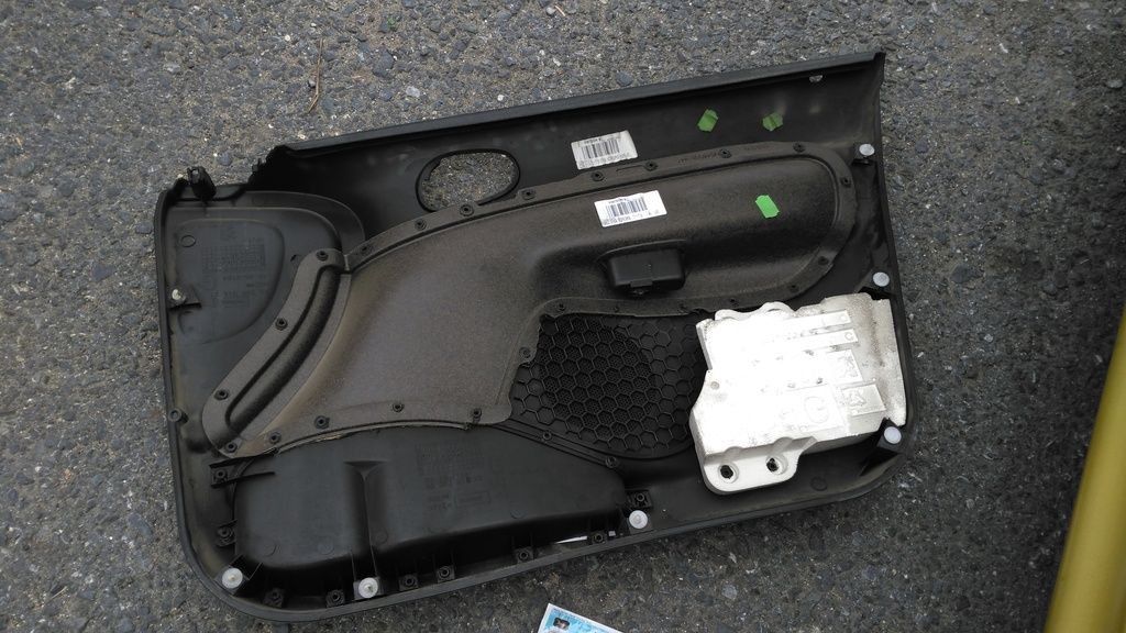

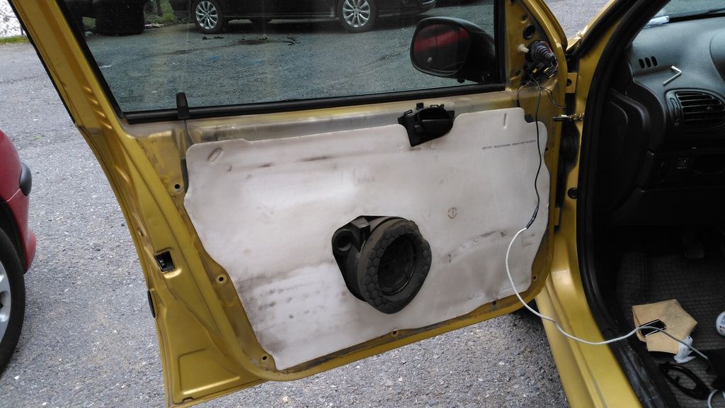

In addition, I pulled parallel from the thin green colored line taken from the ceiling lamp's triggering the door and pulled 4 lines in total to the foot and mirror line.
The hardest part of the job was to pull the cables from the shielded hose between the door frame. After doing this, everyone can do anything.

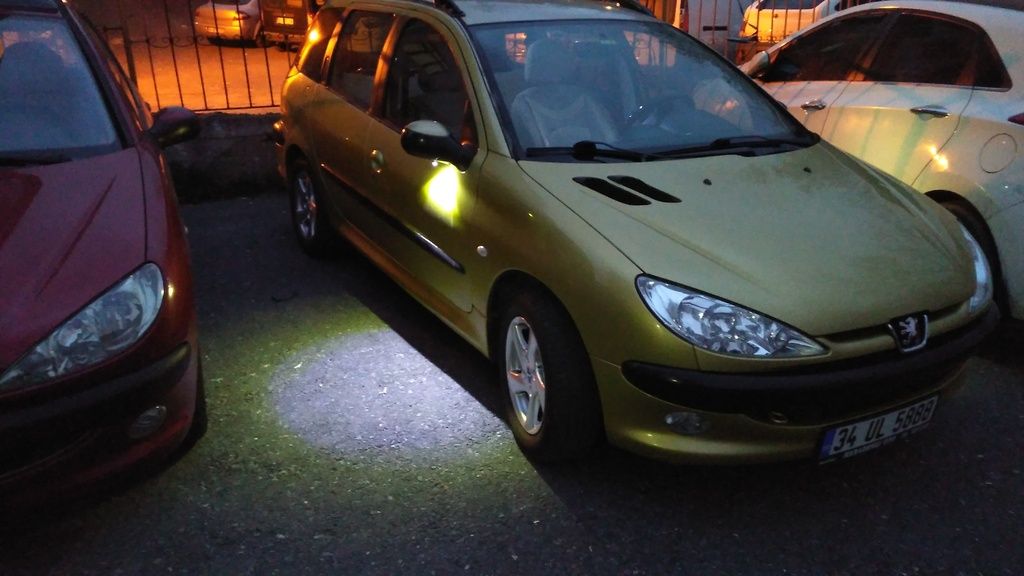

The leds that I put on the foot and mirror line are activated after opening the door when the contact is closed and it turns out when the door locks the door, and it turns out, and a nice image comes out. or if you move the vehicle before one of the doors is completely closed, all leds are flashing.

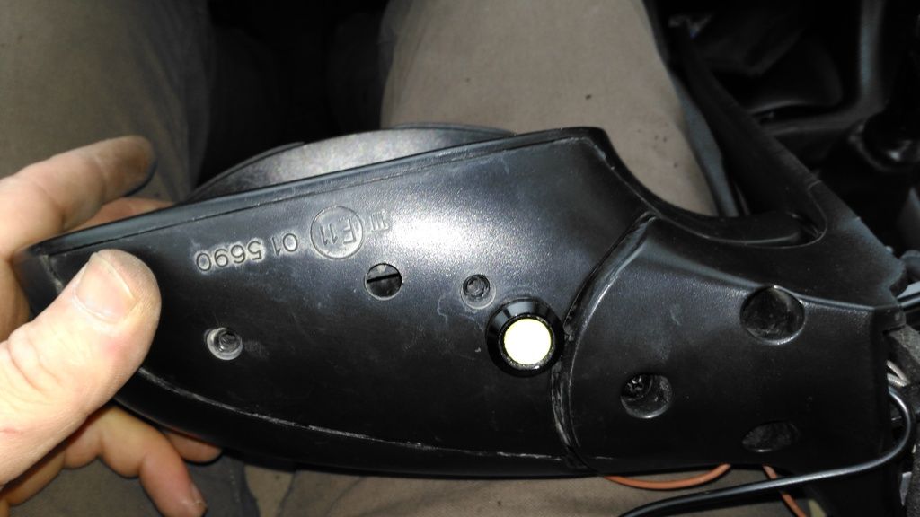

I think it was amazing. I hope you will be satisfied using it. What is the name of those LEDs? Until now, I only used led strip :)
08.05.2020 19:42 # 11
ALLEX
[QUOTE = OguzhanKucuk61] I think it was amazing. I hope you will be satisfied using it. What is the name of those LEDs? Until this time I used only led strip:) [/ QUOTE]
It's called the eagle eye in the market
But you can also buy it when you say lenticular led

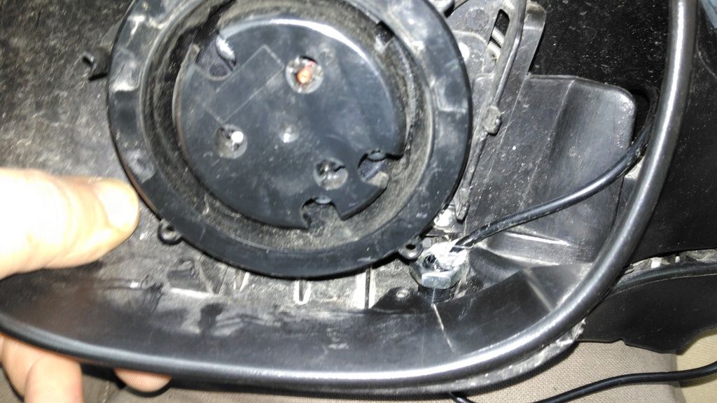

No need to mirror it anyway. Use a normal drill bit and a maximum drill cap of 9.5 mm
The smaller the hole, the better. Also, water does not penetrate under the mirror. If you apply silicone on the inside, it will be healthier.
