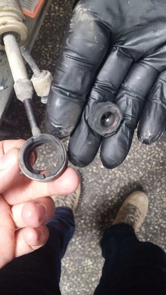

Hello, first of all, get well soon. Just a month ago, the same problem happened to me in 307. There are two ropes going through the gearshift lever. They look like an iron bar, but only the ends are an iron bar, the majority of which is a steel rope. In my car, there is a ring-like ring at the end of this rope and the slot in the middle of this ring is connected to the ring by pressed plastic. the part that controls the gearbox sits in that slot so that it engages the gears. I did not have any problems with the rope, only this plastic was broken, but since it is a part that needs to move constantly, we changed the part so that repairs are not possible. the original is 600 lira, the sub-industry is 200 lira. Actually, maybe it could be pressed plastic again, but I couldn't ask when I had it built, but then it came to my mind. When time is limited, it cost 300 TL in total with 100 TL.
plastic ring and disconnected slot
changing track

Thank you, it's true I don't know about 206 of course, it knows the users better. Even though it changes to 307 even if it is diesel or gasoline. For example, we had a ready-made piece in the master I went to, but for diesel, we bought the part that fit the vehicle.
So, guys, what do you think about the dirum that came to my mind later? Is this part of me that can be repaired?
My master had replaced it with a press since the motor had been stuck in the plastic in his ear. In this piece, plastic is placed in the same manner. Do you think I could have it done, or was it better to change it?
