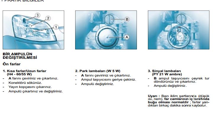

Sa We have a Peugeot partner 1.6 hdi engine has a partner, I wanted to install the parking lamp of a different color, but I would not be happy if you explain how to change this parking lamp with a video

206, turn right to the left and come out directly, but I don't know your partner, you will learn that you are doing what you watch while getting out to an electrician if you do not say that I will wear it myself :)

Thank you, it doesn't even fit. How can I pull it right and left. Thank you. It would be great if you find out how this is done in peugeot partner.

God bless it, I can't find how long I put my hand forward in that light bulb carrier that parking light

You can put a small mirror behind and look.
