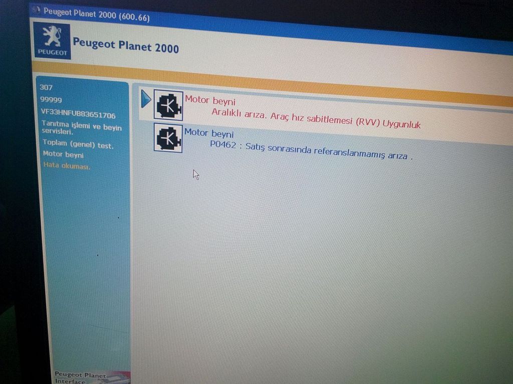

When we connect the car to the brain reading, the breakdown on the screen;
1-Intermittent malfunction. Vehicle cruise control (RVV) compliance,
2- P0462 Non-referenced failure after sales. He gave his mistakes.
I Tamir`C; the cruise control arm will change, he says. Still, he says, if the problem persists, the accelerator pedal will change. I would like to get your opinion on the subject.

There is a problem with your accelerator rather than speed stabilization. When you encounter such a situation, when you remove the socket from the brake or clutch coupling, the fixing will be deactivated directly. You pedal last.
08.05.2020 20:02 # 6
palet
Thank you so much. Even though I turned OFF on the cruise control arm, when there was no change in the speed of the vehicle, it made me think that it did not come off the cruise control and therefore there was a malfunction in the "stabilizer arm". Now it's clearer. Let's start with changing the accelerator pedal. palette 2016-11-20 21:24:41

After this incident happened to me, I did not activate the "cruise control" again. I will try again today. If it comes into play; it will be certain that the defective part is the accelerator pedal. (The mechanic first said that while the vehicle is on the cruise control, the accelerator pedal does not move physically, the injector gives gas from the brain, so the pedal is at the bottom, has nothing to do with the cruise control. He said let's change. palette 2016-11-22 23:02:50

I used it 4-5 times on cruise control today. There was no problem. Diagnosis of our friend of blush is correct. that means the problem is on the gas pedal. Without pressing the brake pedal, the cruise control is deactivated by simply pressing the clutch.
As soon as possible, I will disassemble the accelerator and control it outside. If I have time; I would like to take a video of the pedal removal and maintenance process and upload it to youtube. There are videos for other vehicles but not for pejo.
