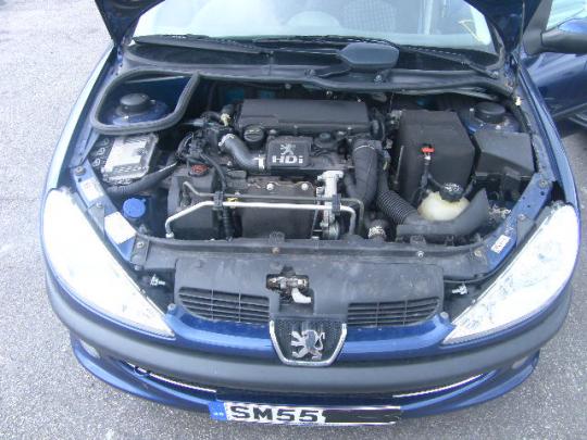

Hello, When I Bought The Vehicle, I Have A Hose Where I Shown It In The Picture I Should Not Have It In My Car, It Is Not Removed, Is Not Stuck Back Or Fell My I Want To Ask What is the purpose of this Hose?
normally it should be like the picture below

why did they remove the air inlet hose? I don't know what the harm will be, I think I'm sure it will be take and plug.
08.05.2020 19:32 # 3
sonerkyl
the air inlet hose that honor says is the purpose of that part like water - earth - stone - dust - etc. you can think of it as preventing the vehicle from entering the engine directly. corrects it if i am wrong friends.
08.05.2020 19:32 # 4
Karaoglan
Strange Part of the Work I Can't Find in the Particles This hose is not even in the removers, but when I put my hand in front of it, light warm air is coming.

madblueblacksea
The vehicle in the picture attached receives the fresh air from the end of the hose, in front of your vehicle radiator. The difference is that it provides clean and cool air intake from the back of the left headlight through the hose. In the absence of a hose, some kind of warm air (the situation changes when the fan turns on) passes through the radiator and dust from the ground enters more easily. I didn't have it in my car, I didn't have it in the particle. It is sold on the Internet for 65 TL, but since I didn't see it, I gave up on taking it,
this is the piece: d was fine but i guess the seller links are no longer shared Ouch
