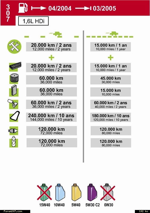

HDI engine timing change period in normal conditions in 10 years 240,000 km, 180,000 km for 10 years in harsh conditions, vehicle chassis number you assign to your e-mail from Peugeot Turkey's communications department information they give back within 48 hours. The timing belt is missing from peugeot's THP engines. Available in all HDI engines.

You are late for your previous vehicle, sir, 5 years timing change in gasoline, I changed the timing of my 206 1.4 HDI vehicle in 9 years 117.000 km. This information is not the information I hear from right to left, but the information that I communicate and receive through the official website of my peugeot and my peugeot.
This is My peugeot maintenance plan.
Serkan 2014-07-16 05:56:36

My recommendation for 5 years or 120 thousand km but 90 thousand km

the timing belt changes in 90 thousand or 5 years, it should be changed, it is recommended, the chain is in the block and there is no change period unless it indicates a failure. if it makes a sound, change is required. With the quality and regular oil change, damage to the chain is eliminated.
